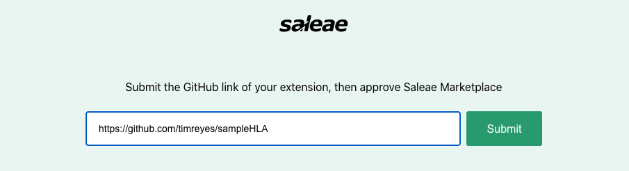

2. Clicking 'Publish' should open your browser and load our extensions submission page. Provide your GitHub repository URL here and click 'Submit'.

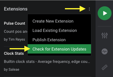

5. Click the three dots at the top of the Extensions panel and click 'Check for Extension Updates.'

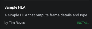

6. Congratulations! If the publish was successful, your extension should now appear in the software like below.
