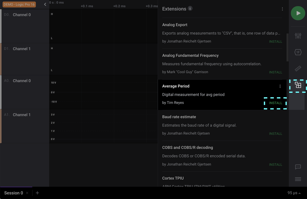

Extension Installation within the Software
This will be the easiest method of installing an extension. Clicking on the Extensions button on the right will open up a list of published extensions from us and from the community. Afterwards, you can click "Install" for the extension of your choice.

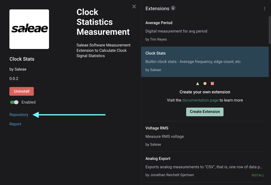

  1. On a computer where the marketplace loads, click the extension of interest so that it is highlighted. This will open up the extension information within the software.
  2. Click the "Repository" link. This opens the github.com repository for that extension.

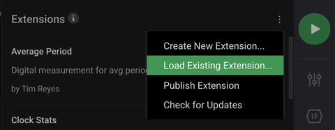

  5. In the Logic 2 software, on the Extensions panel, click the "three-dots" menu icon, select "Load Existing Extension..." and select the downloaded extension.json file.

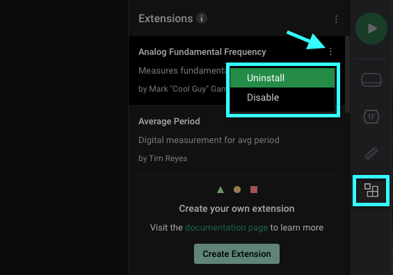

Uninstalling an Extension
To uninstall an extension, click on the 3 dots next to an extension in the Extensions panel. Then click Uninstall.
