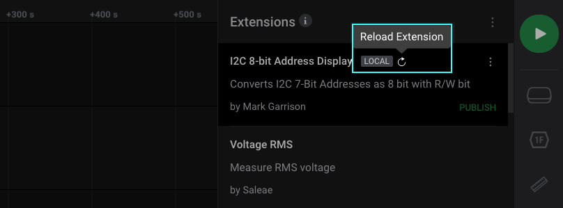

  • Use the reload source button in the app to quickly re-run your HLA after editing your source code.
"Reload Extension" button

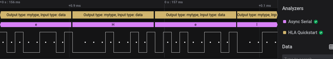

If you open the example data from above and add this analyzer, selecting the Async Serial analyzer as input, you should see the following when zooming in:
Our HLA (top) is outputting a frame for every frame from the input analyzer (bottom), and displaying their types.

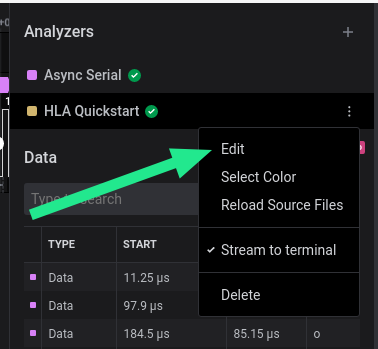

After applying the changes, you can open the menu for your HLA and select Reload Source Files to reload your HLA:

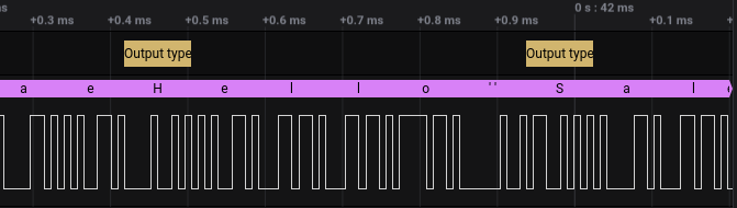

You should now only see HLA frames where the Async Serial frame is an H or l:

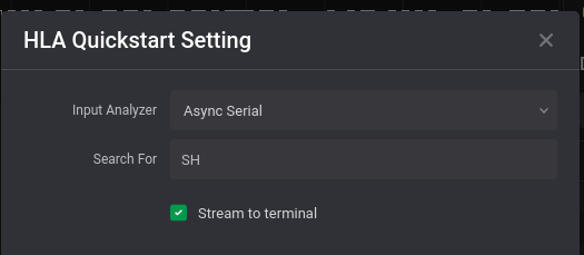

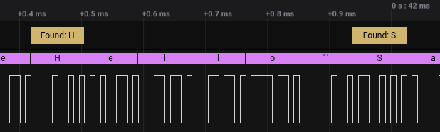

Now if you can specify the characters to search for in your HLA settings:
Click Edit to show the settings
Set the "Search For" setting
Now only the values 'S' and 'H' have frames

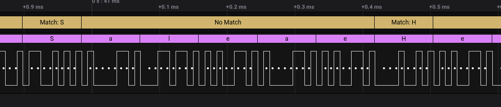

The final output after reloading:
