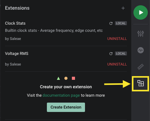

  1. Click the 'Extensions' panel button on the right of the software
2. Click 'Create Extension'

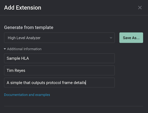

3. Under 'Generate from template', choose the type of extension you would like to create. For this example, we will create a High Level Analyzer.
4. (Optional) Click 'Additional Information' to fill in information about your extension.
5. Click 'Save As...' to save and select your location.

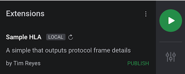

6. You should now see your new extension listed as 'Local' in the software.

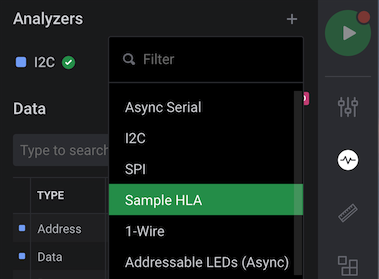

2. Click the Analyzers '+' button to add our Sample HLA.
3. In the settings popup, select 'I2C' under Input Analyzer. For the rest of the settings, you can leave them as default and click 'Finish'. Once you add the HLA, you can see it as a virtual channel as shown in the image below.

To edit the Sample HLA (perhaps as a starting point to creating your own HLA), you can click the 'Local' button next to 'Sample HLA' under the Extensions panel. This will open the containing folder for your extension files which you can update for your needs.

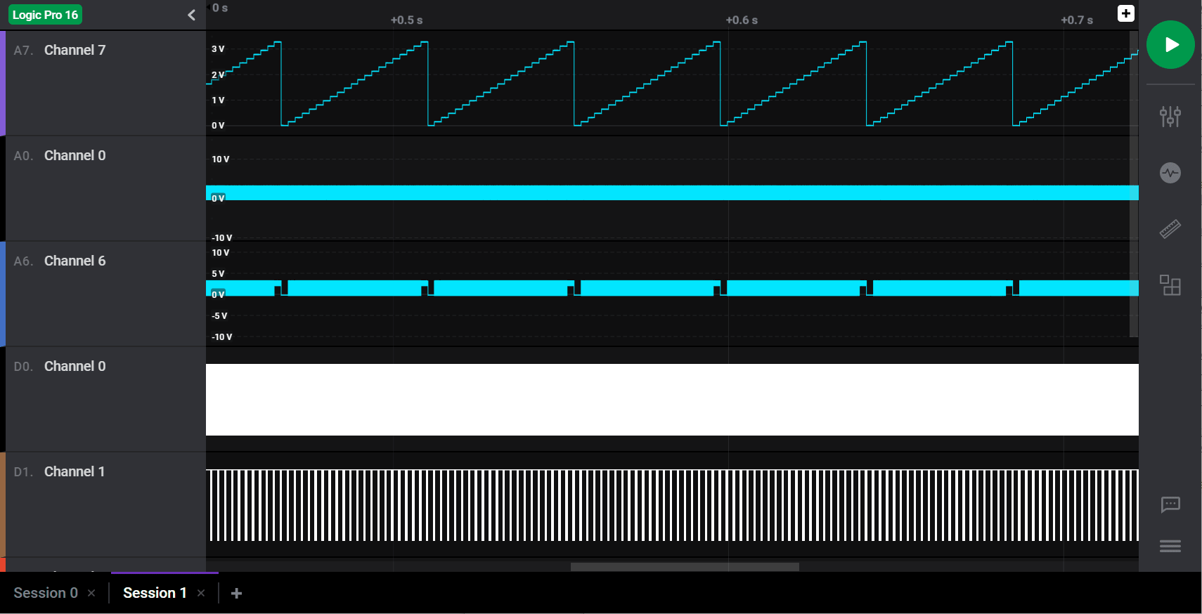

To see your new measurement in action, take a capture of digital data and add a measurement to it as shown above. You should see the new measurements:
