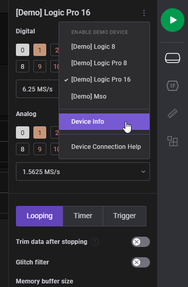

To find the serial number of a connected device, open capture info sidebar and click the device dropdown in the top right:
Device info

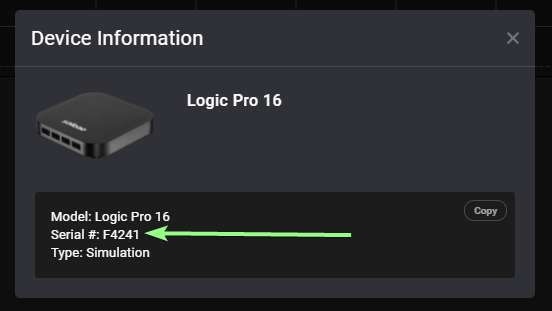

If the device you want the serial number for is not selected, select it. Then click "Device Info" - this will open a popup with information about your device, including its serial number.
Device serial number
You can copy the serial number from here and use it in your Python script where a "device_id" is required.
